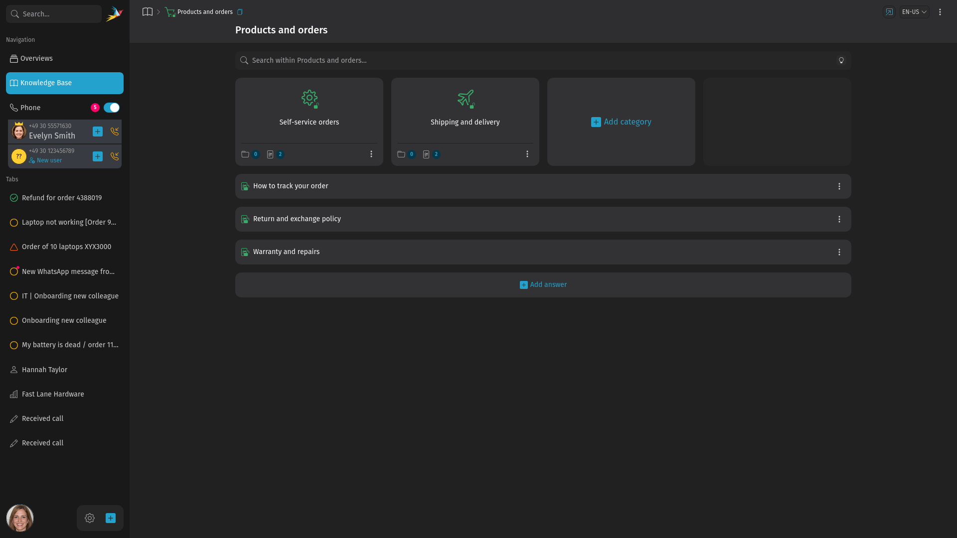

Browse
The knowledge base home shows one tile for every top-level category, arranged in a grid. Each tile shows the category icon, its title, its publication state and two counts: the number of subcategories and the number of answers it contains across all subcategories.
To open a category, simply click on its tile. Its subcategories appear as tiles on top, its answers below them as a list. Select an answer to read it. Use the back and forward buttons in the top bar to jump between previous and next answers inside the same category.

Категорије
To create a category, select the + Add category card. This works on the knowledge base home for top-level categories as well as inside a category for subcategories. Another way to create a new category inside another category is to use the ︙ button on the category tile and select Add sub-category.
Each category consists of a title and an icon. Icons help users recognize categories at a glance, so pick the one that fits the content best.

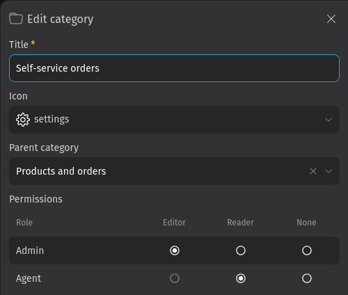

To edit a category, click the ︙ menu on its tile and select Edit category or use the identical button on the top of the right sidebar when inside a category.
Category permissions
The category flyout contains a Permissions matrix that assigns individual roles their own access level to a category. Three levels are available: Editor to read and edit the content of the category, Reader to read it including internally published answers and None to hide it from the role (published answers are always visible in the published knowledge base). Roles without the knowledge base reader or editor permission have no row in the matrix.
By default, access is managed globally: everyone with the knowledge base reader permission sees all internally published answers, editors can work with everything. Saving a permission matrix for the knowledge base or a single category that differs from these defaults switches the whole knowledge base to granular access: content visibility then follows the per-category permissions. Selecting only the access a role already has by default is not stored and keeps the global behavior.
Permissions of a parent category are inherited by its subcategories. An inherited Editor or None level cannot be overridden in the subcategory, the matching options are locked. An inherited Reader level can be changed. The Editor option is locked for roles that only have the knowledge base reader permission. A change that would take away your own editor access to a category is rejected, regardless of your other roles. Published answers stay available to everyone, granular permissions only affect internal answers and the editing of content.
Одговори
To add an answer, open a category and select the + Add answer entry or use the category's ︙ menu and select Add answer there. An answer consists of a title and rich content. The editor provides the same formatting capabilities as the ticket article editor. See the formatting section of the editor guide for details. Tags make answers easier to find, both in the knowledge base search and while working on tickets.

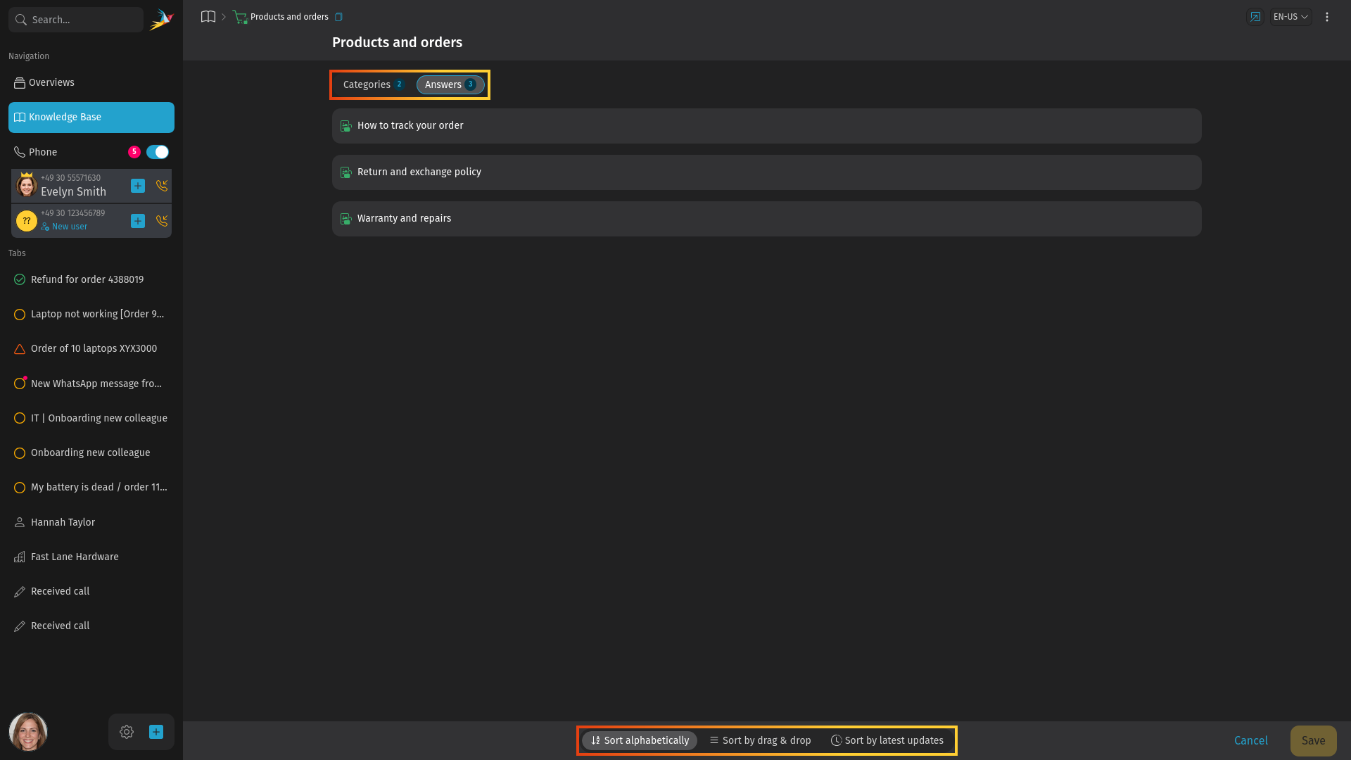

Sort content
Categories and answers can be sorted per category. Open the ︙ menu in the top bar and select Sort content. The sorting bar appears at the bottom of the screen. Inside a category, switch between the Categories and Answers tabs to arrange the two lists separately; the knowledge base home sorts its top-level categories.
Three sorting modes are available for both answers and categories. Answers and categories can be sorted independently.
| Mode | Effect |
| Sort alphabetically | Entries ordered by title, regardless of manual changes |
| Sort by latest updates | Most recently updated entries first |
| Sort by drag & drop | Your hand-picked order; drag the entries into place |
For categories, latest updates means the category's own editorial changes like a renamed title or a new icon. Changes to the answers inside it do not affect the category's position. Answers are dated by their content edits.
Select the mode, arrange the entries if needed and save. The order applies for everyone who views the knowledge base.

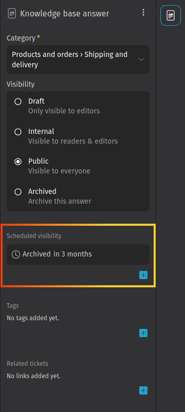

Visibility and scheduling
To change the visibility of an answer, edit the answer and select the new visibility in the answer sidebar; it takes effect immediately when you click Update. Use drafts to prepare content that is not ready for release, and archiving to retire outdated answers without deleting them.
Instead of changing the visibility manually, you can schedule visibility changes: an answer can be published automatically on a given date, or archived when it becomes obsolete. Scheduled changes are listed in the answer sidebar and only visible to editors. Create a new schedule by clicking the + button in the Scheduled visibility section in the answer edit mode.
Schedules follow the order of the visibility states: an answer can become internal, then published, then archived, each with its own date. Drafts cannot be scheduled and a visibility state that the answer has already reached cannot be scheduled again.
